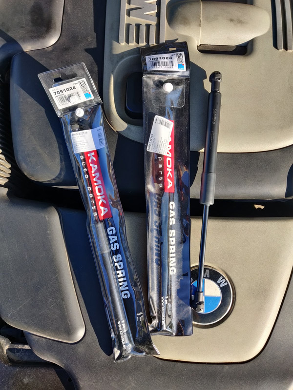

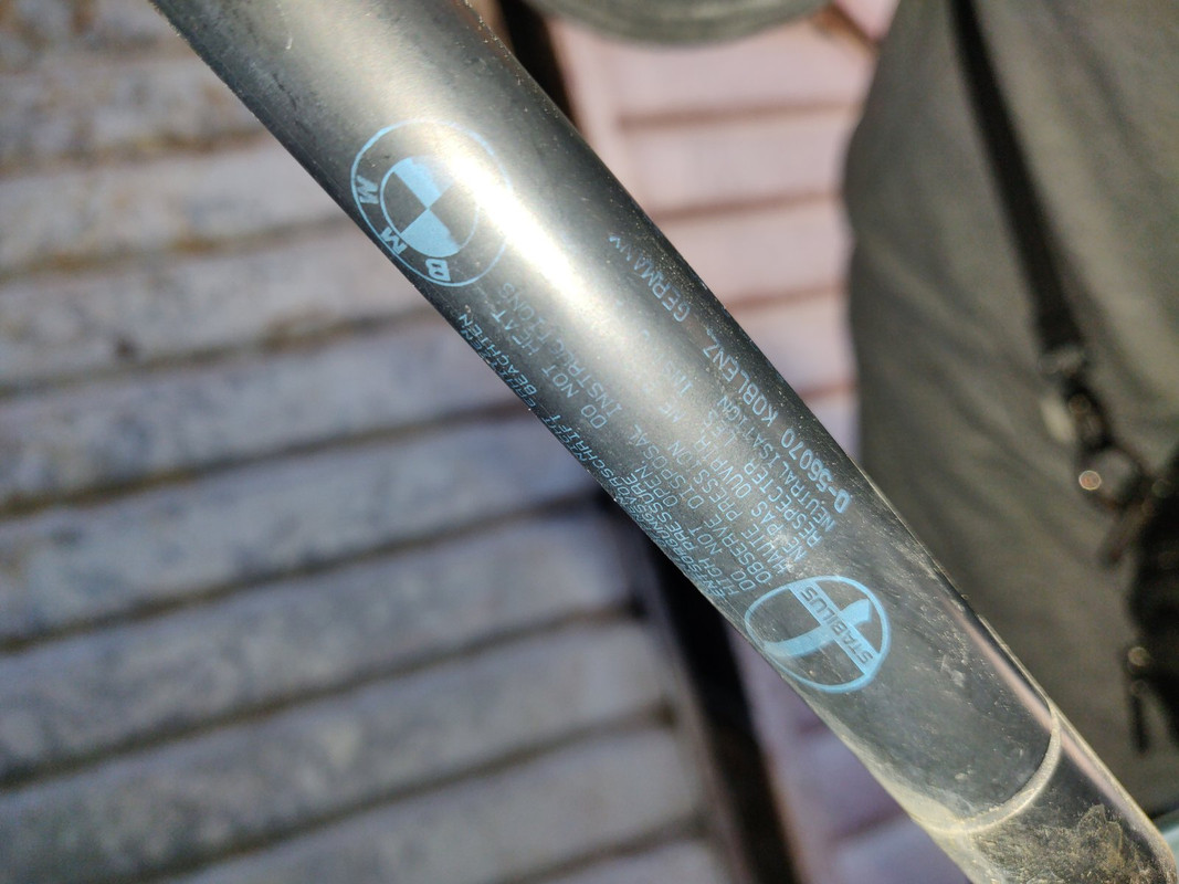

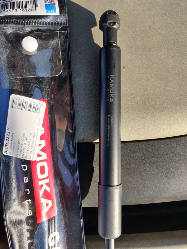

pcx 0 Posted April 28 Author Report Share Posted April 28 Amortizeri haube popustili cim malo zahladnelo ... jos su originilni bili na njemu. Zamenjeni, sad se hauba jedva moze spustiti Link to post Share on other sites

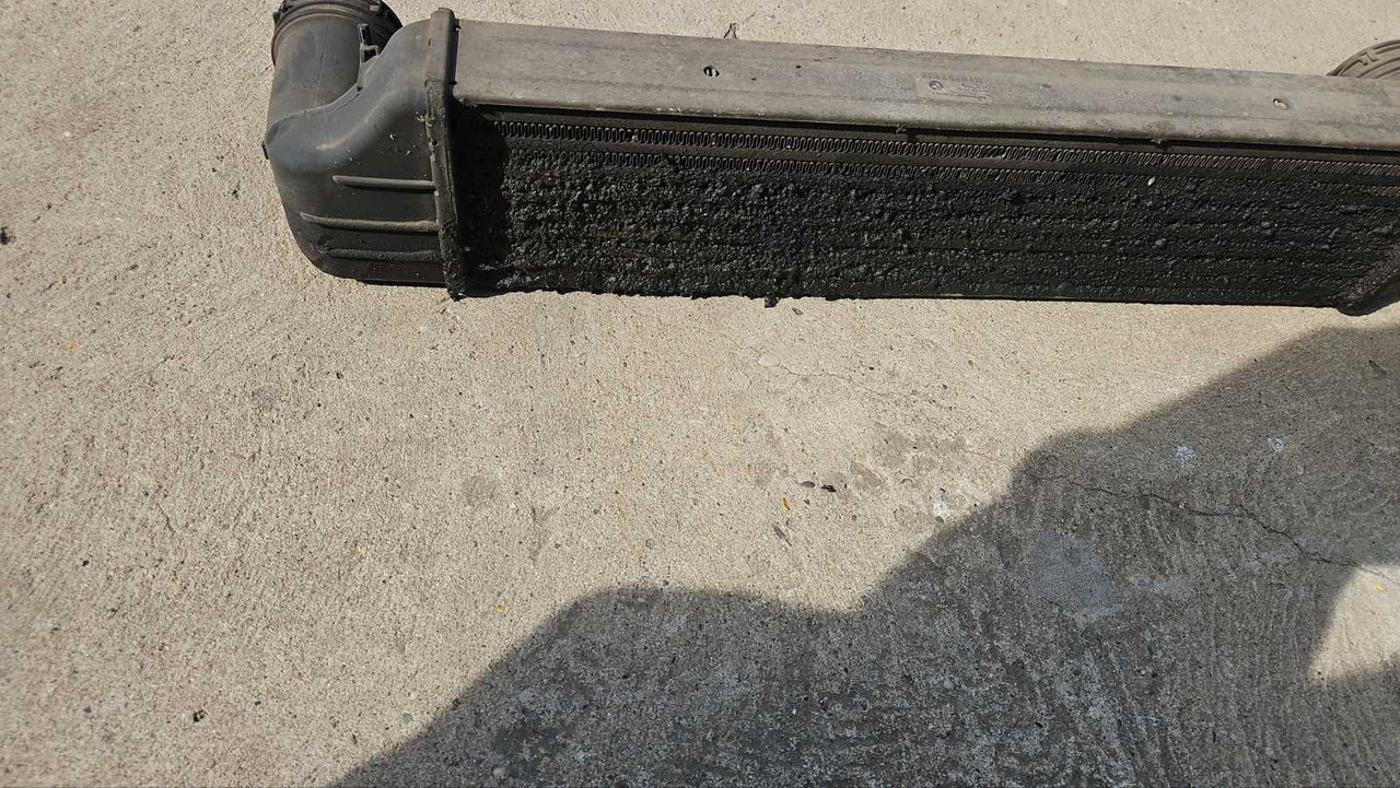

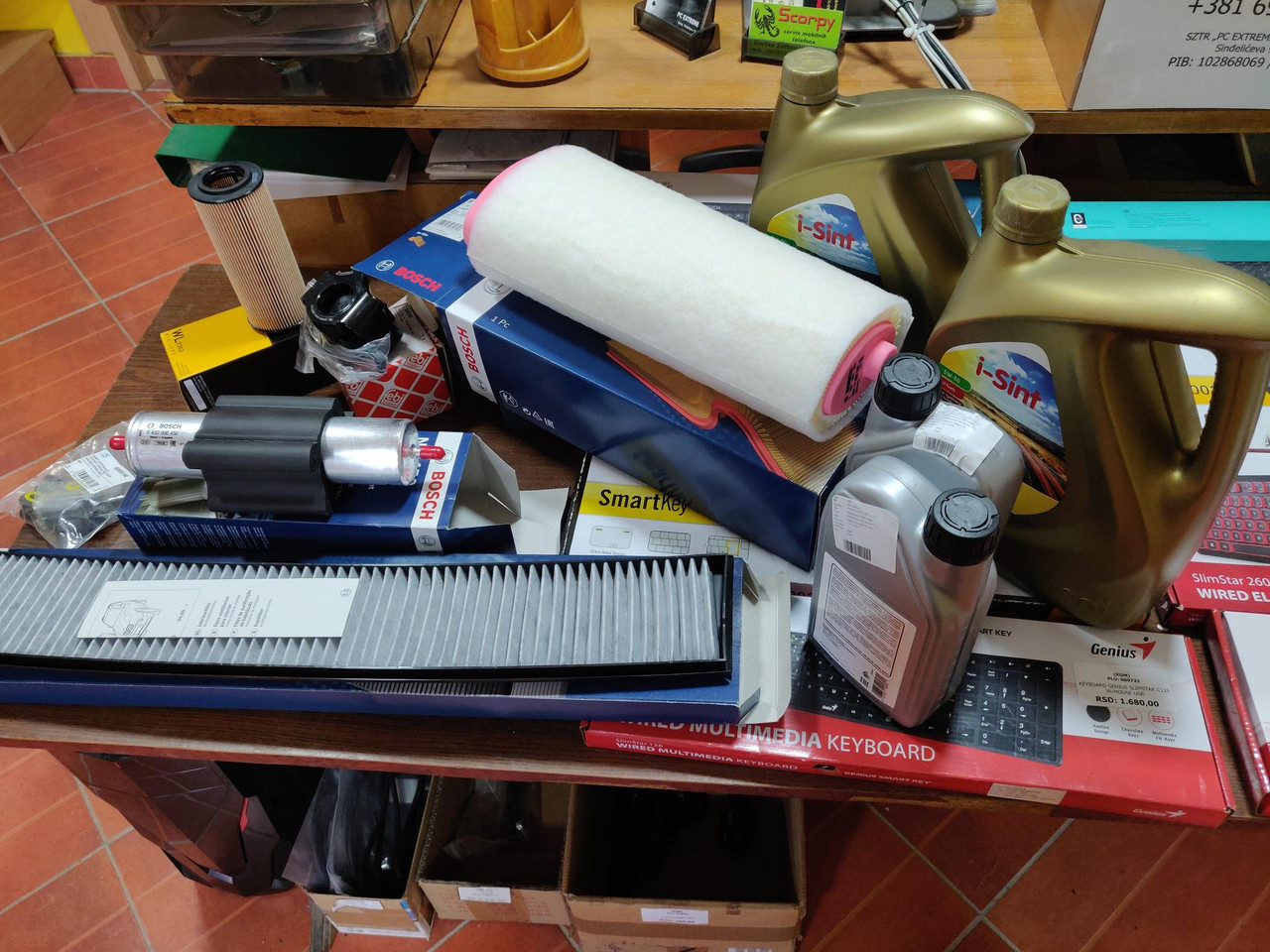

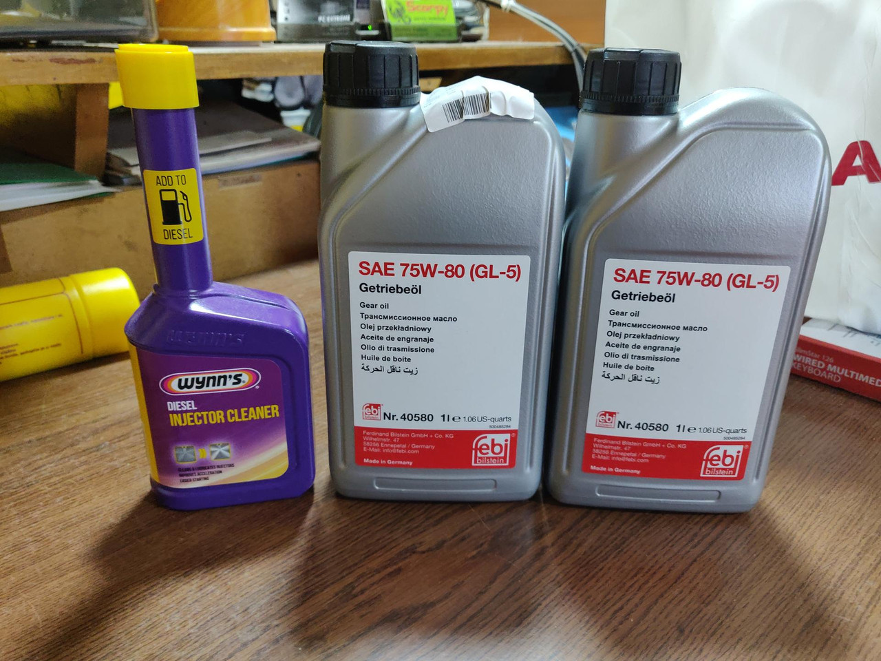

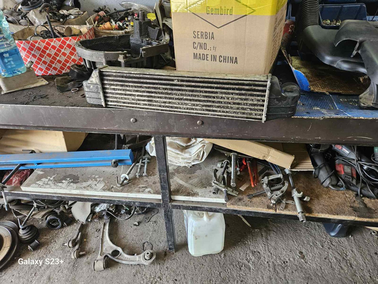

pcx 0 Posted April 28 Author Report Share Posted April 28 2025 Procistili malo dizne Wynns Diesel Injector Cleaner-om ... Zamenjeno: - Ulje u menjacu ( FEBI SAE 75W-80 GL-5 – 2x1 Litre ) - Pise lifetime oil na menjacu ... bas - Ulje ENI 5W-30 full sintetika 5.5L - Separator uljnih isparenja FEBI Bilstein - Filter goriva Bosch - Filter ulja Wix - Filter vazduha Bosch - Filter kabine Bosch Saniran novi kamencic na soferci Zamenjen levi zadnji parking senzor i konektor Uradjen mali servis, opran i ispran intelkuler Link to post Share on other sites

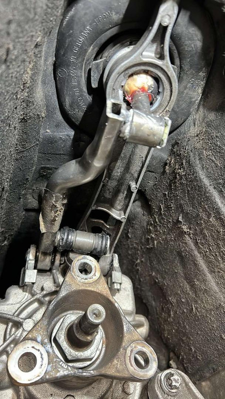

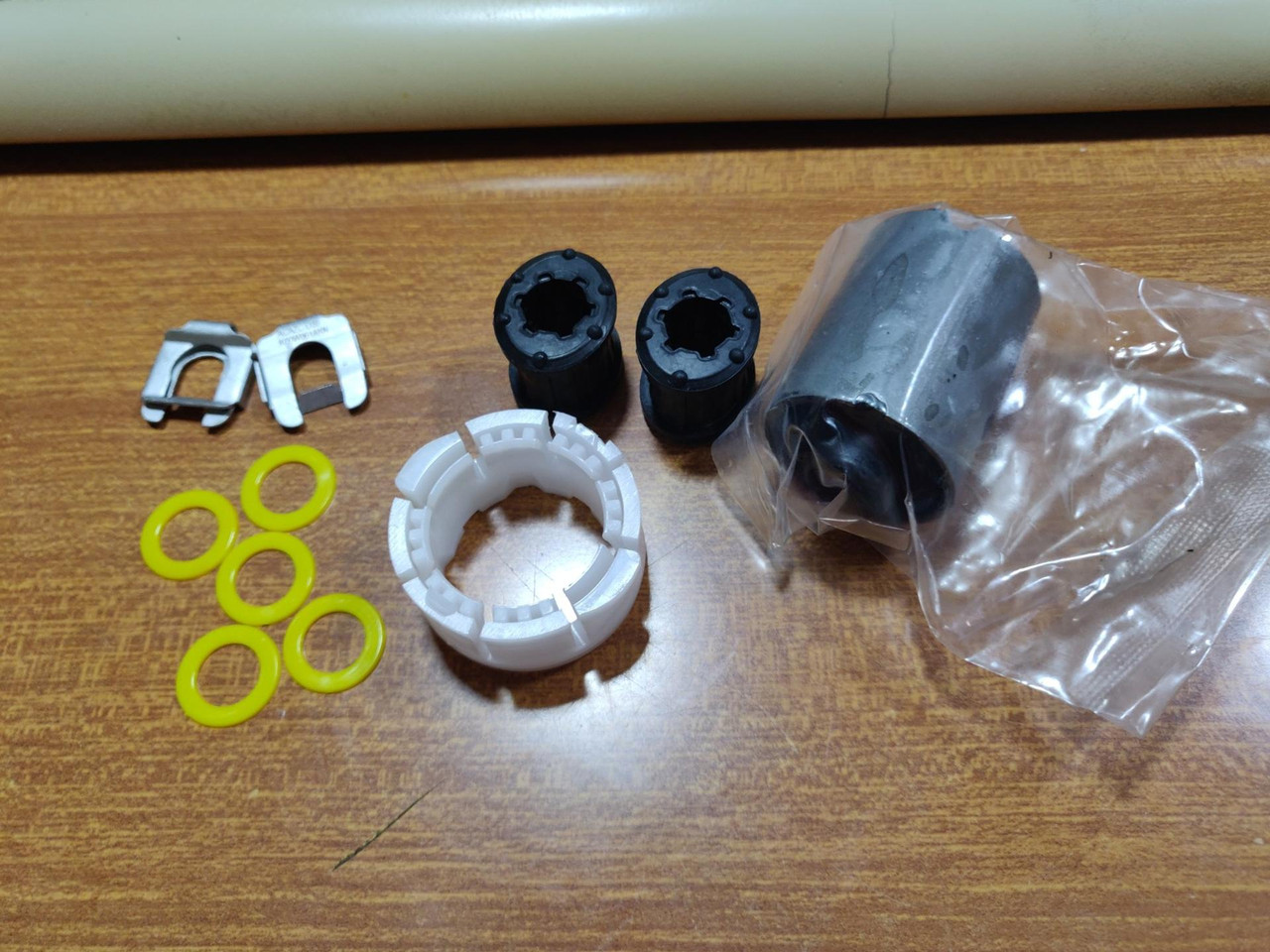

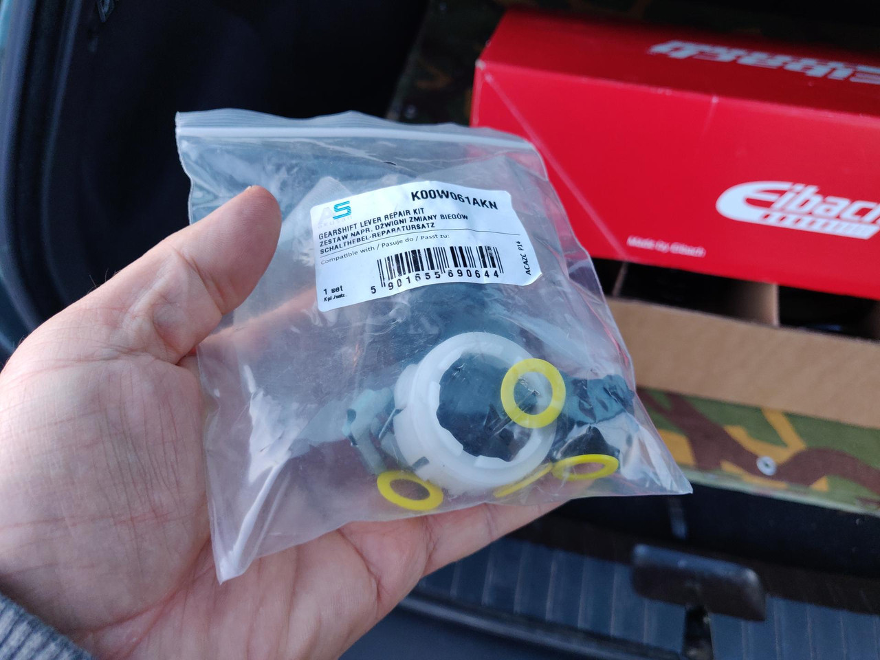

pcx 0 Posted April 28 Author Report Share Posted April 28 Ugradjen set za reparaciju rucice i poluge menjaca Link to post Share on other sites

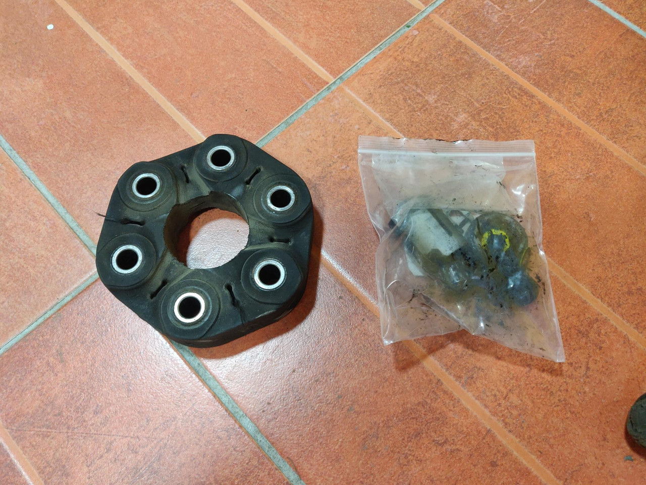

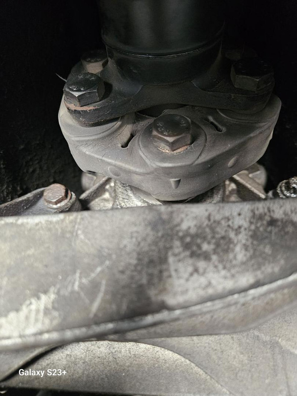

pcx 0 Posted April 28 Author Report Share Posted April 28 Zamenjena oba prednja stabilizatora Zamenjena Hard Guma kardana ( Meyle ) Link to post Share on other sites

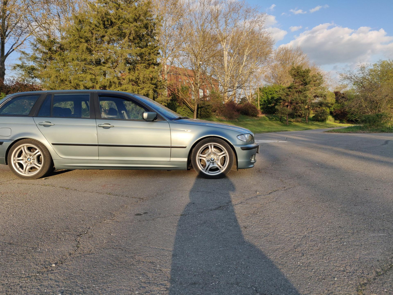

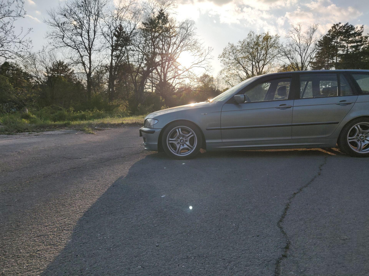

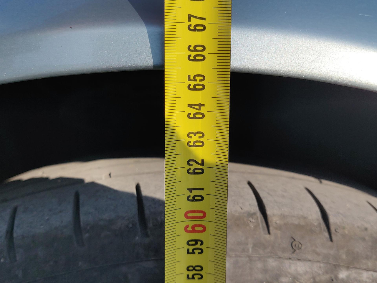

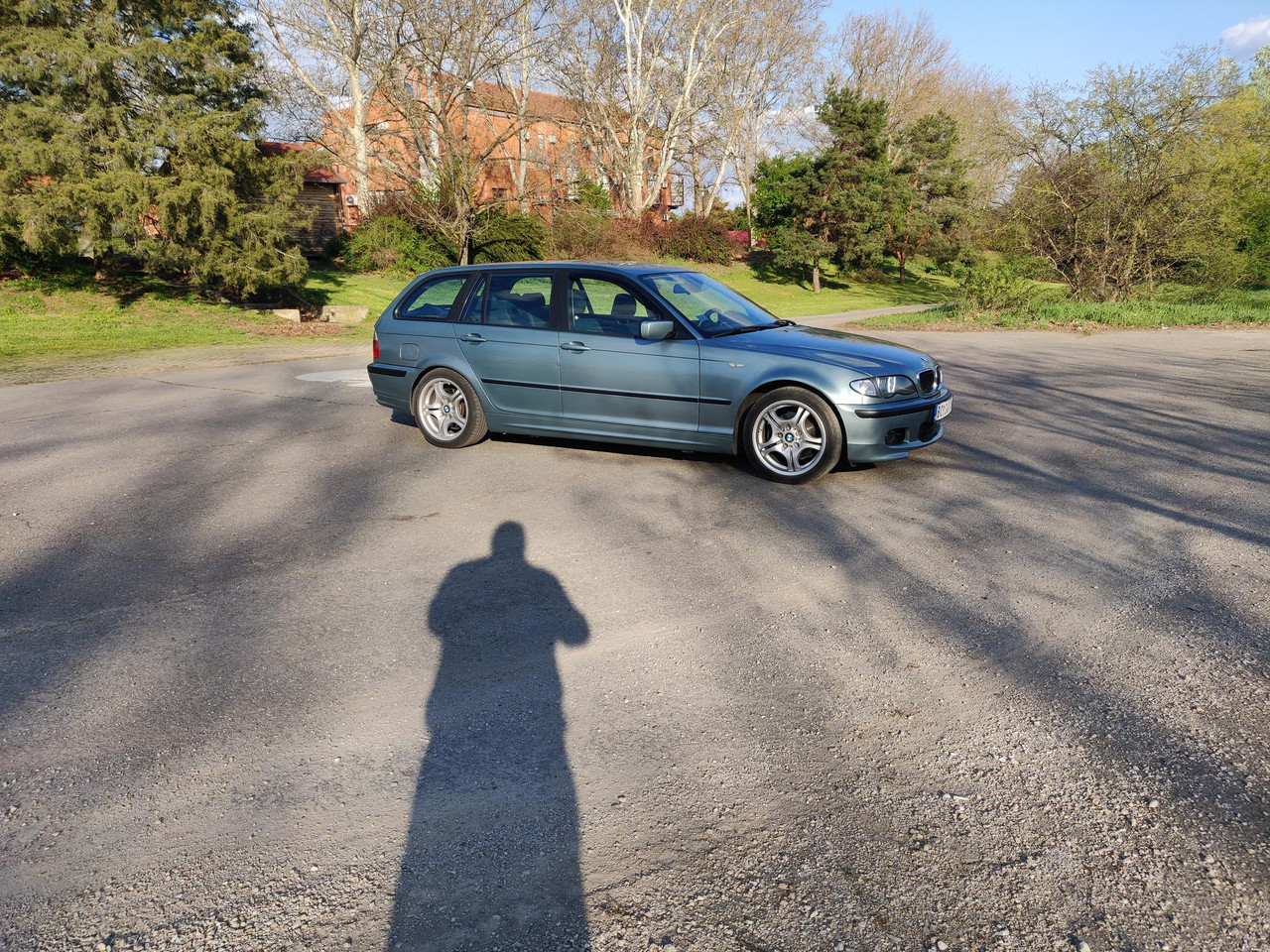

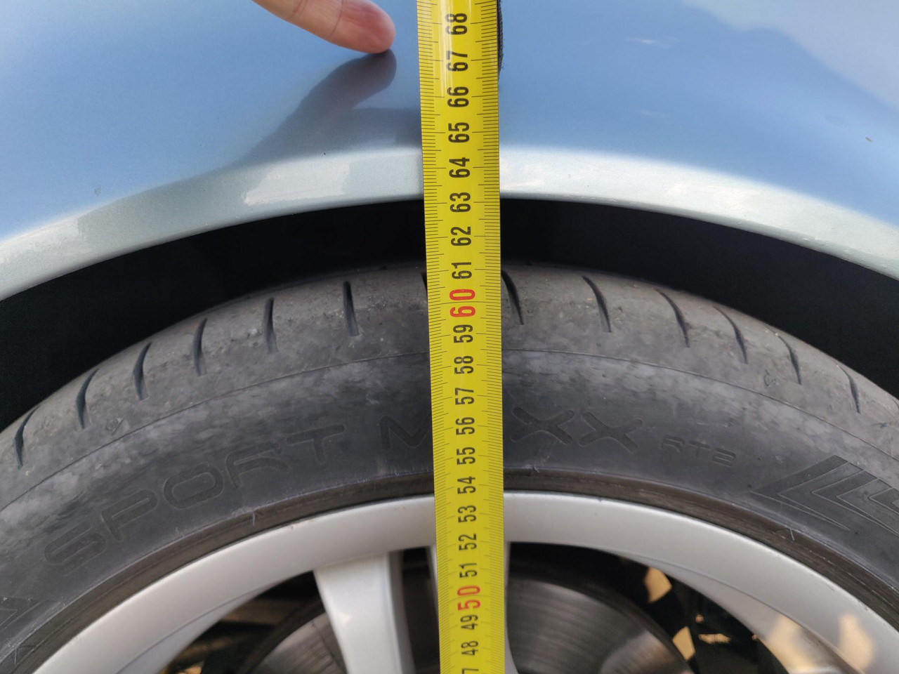

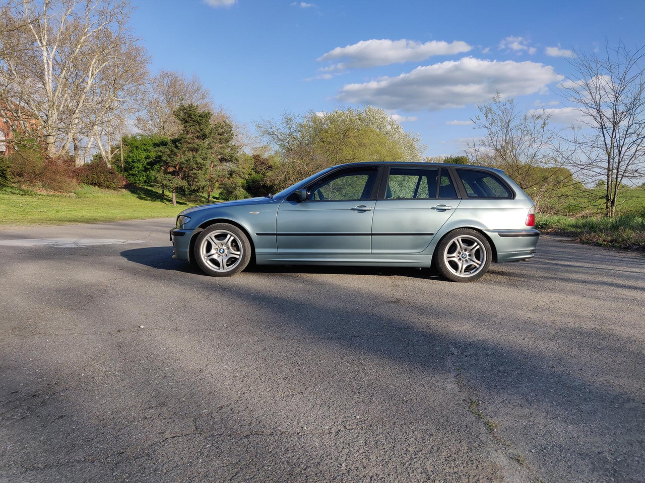

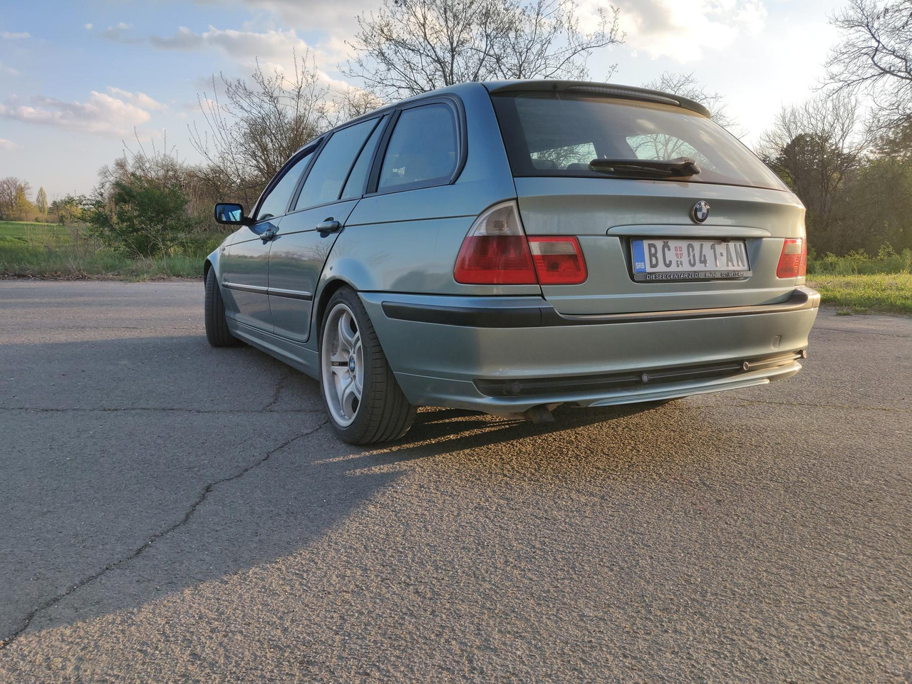

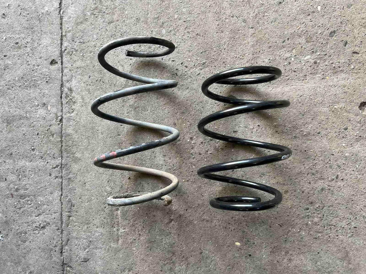

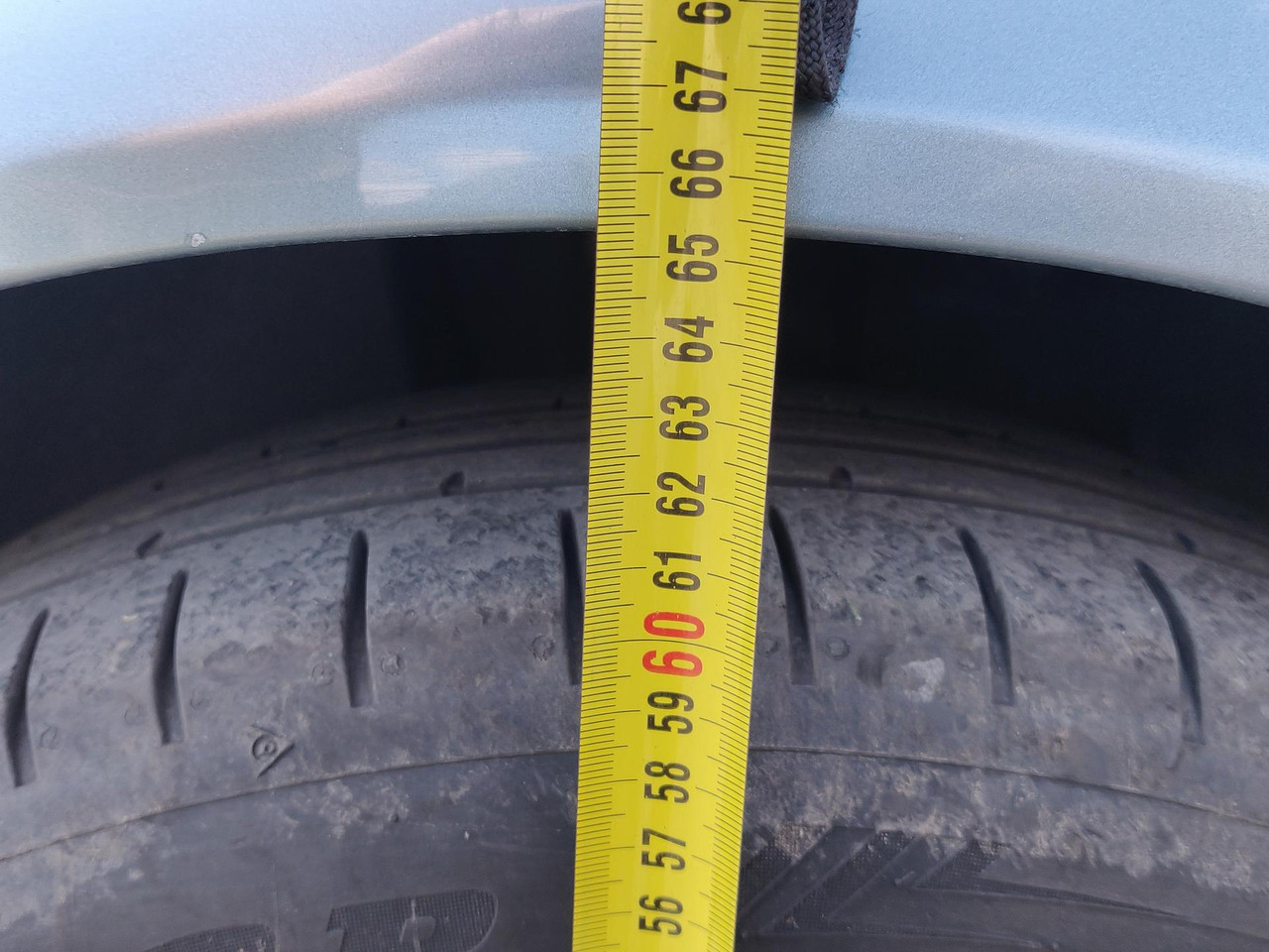

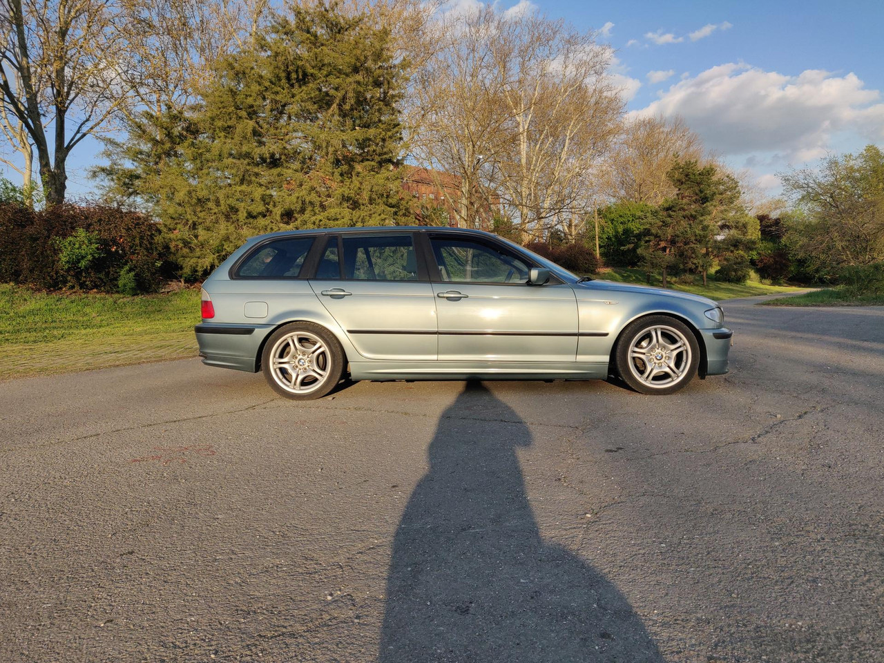

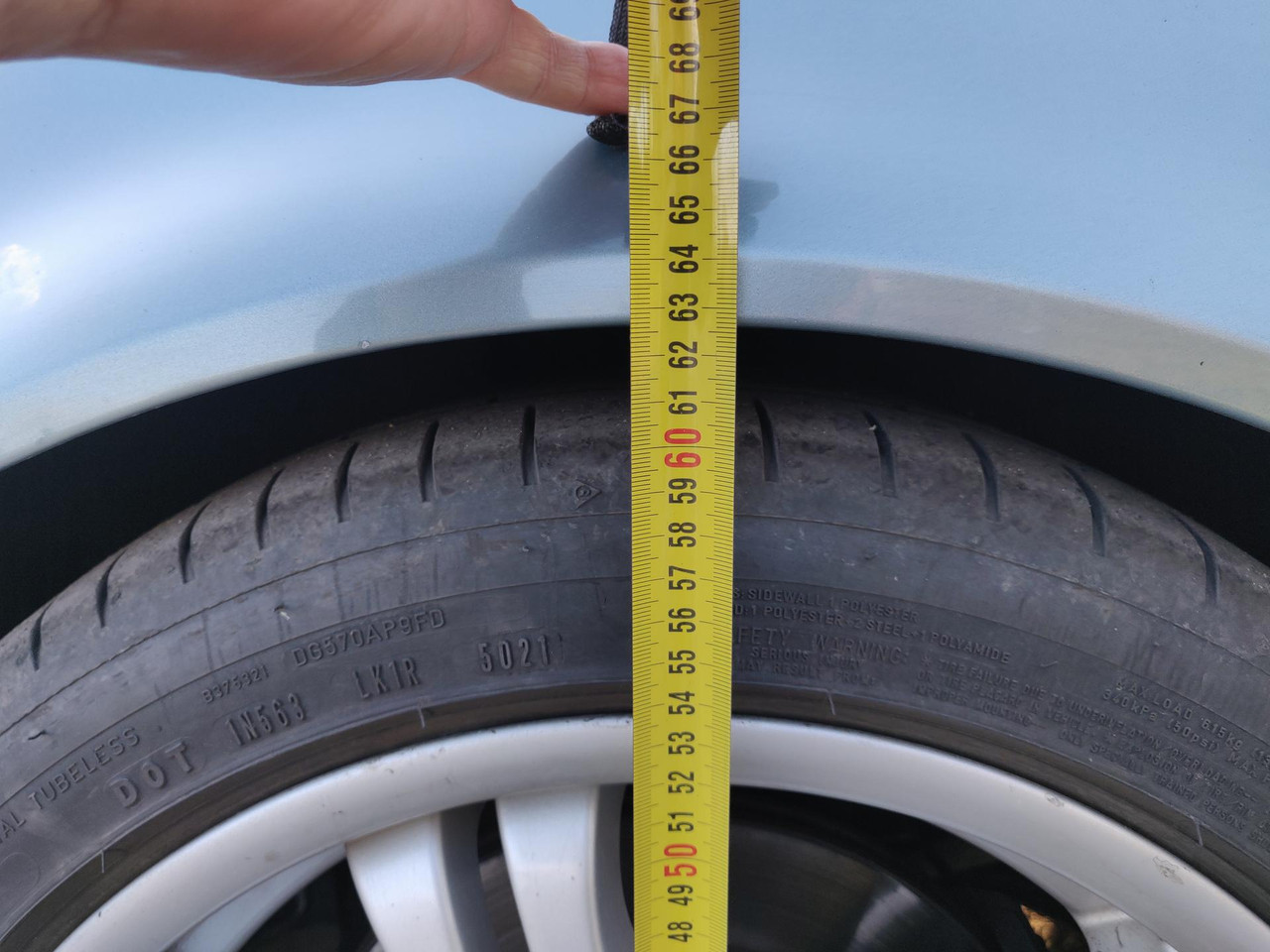

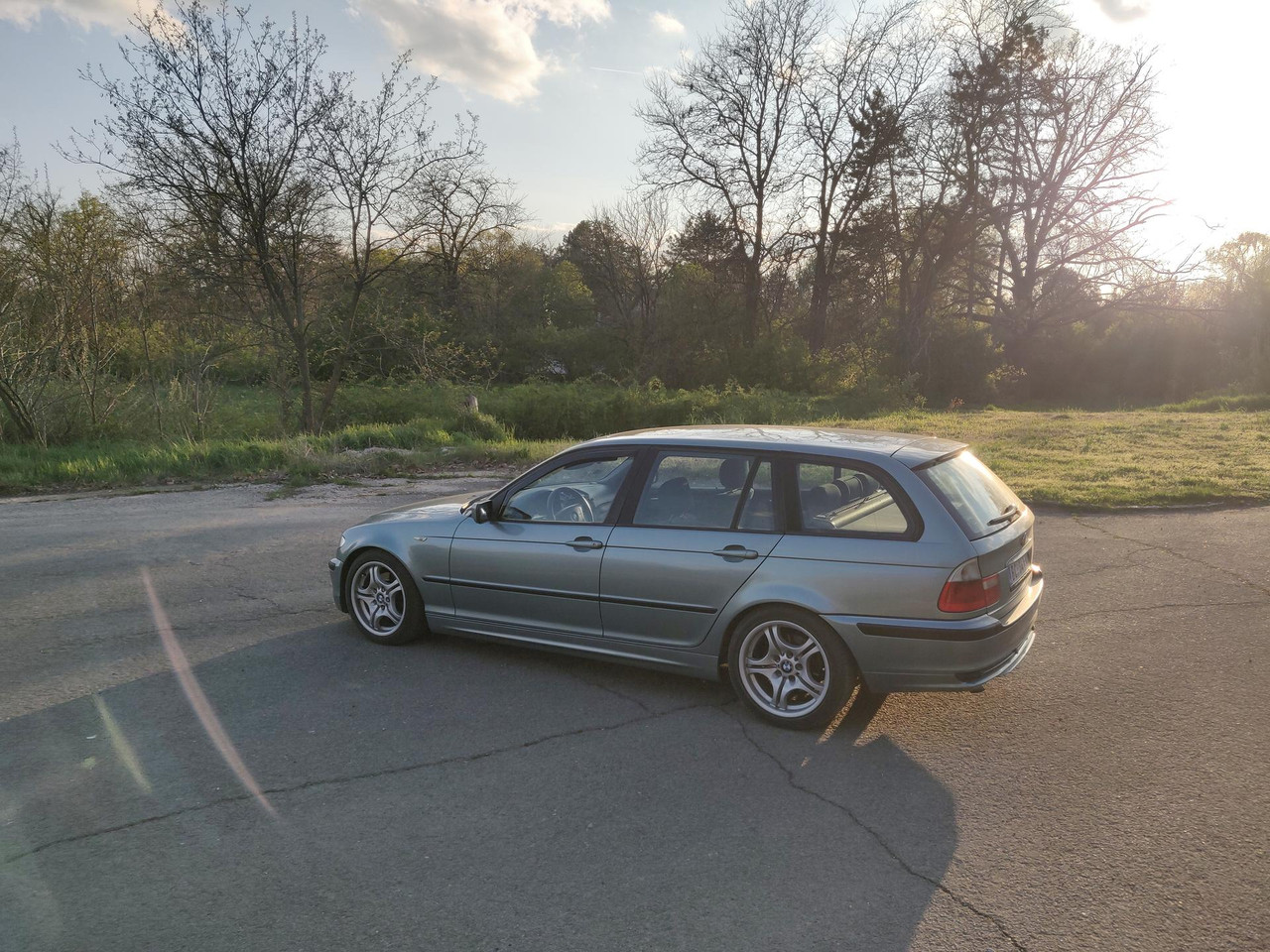

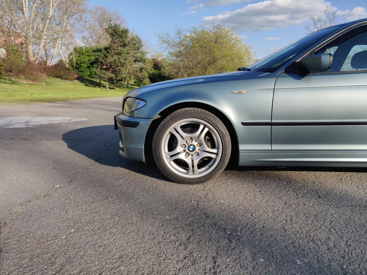

pcx 0 Posted April 28 Author Report Share Posted April 28 Nabavljen set Eibach Pro Kit opruga - spustaju napred 3cm a nazad 2cm Zamenjene prednje opruge, zadnje ne menjam posto mi bas ovako vizuelno odgovara izgled auta. PRE : POSLE : Trenutno stanje ... Link to post Share on other sites

castor 0 Posted April 30 Report Share Posted April 30 On 4/28/2026 at 2:15 PM, pcx said: Nabavljen set Eibach Pro Kit opruga - spustaju napred 3cm a nazad 2cm Zamenjene prednje opruge, zadnje ne menjam posto mi bas ovako vizuelno odgovara izgled auta. Isto sam i ja uradio bio na mom karavanu, jer sa zadnjima glisira. Stavio sa regularnog karavana i dobio tačno ono štop sam htjeo - veoma ujednačen razmak između točka i blatobrana i napred i nazad. Da sam to znao kada sam nabavljao opruge, uzeo bih bio samo prednje, jer može i tako... Svaki put je sve ljepši i ljepši. Link to post Share on other sites
