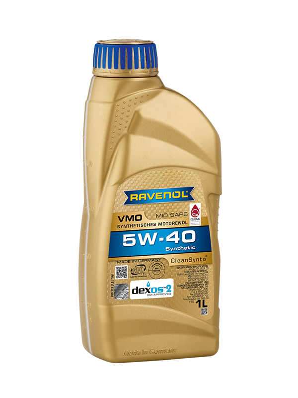

Mozes sipati 5w40 bmw LL04, nema mnogo takvih ulja, ali se nadje poneko, kao npr. nemacki ravenol.
https://www.ravenol.de/en/pdf/ravenol-vmo-sae-5w-40.pdf
p.s. takodje postoji recimo motul bmw specific LL04 5w40
