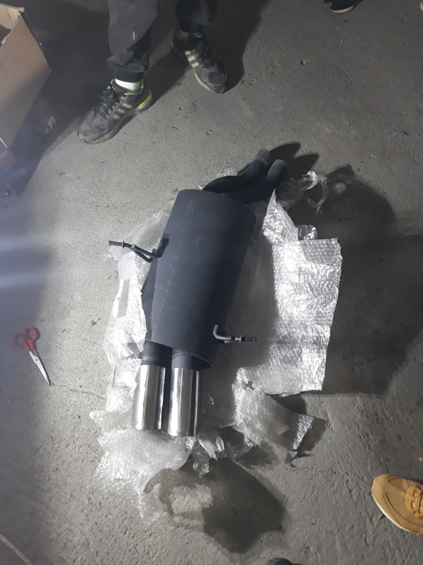

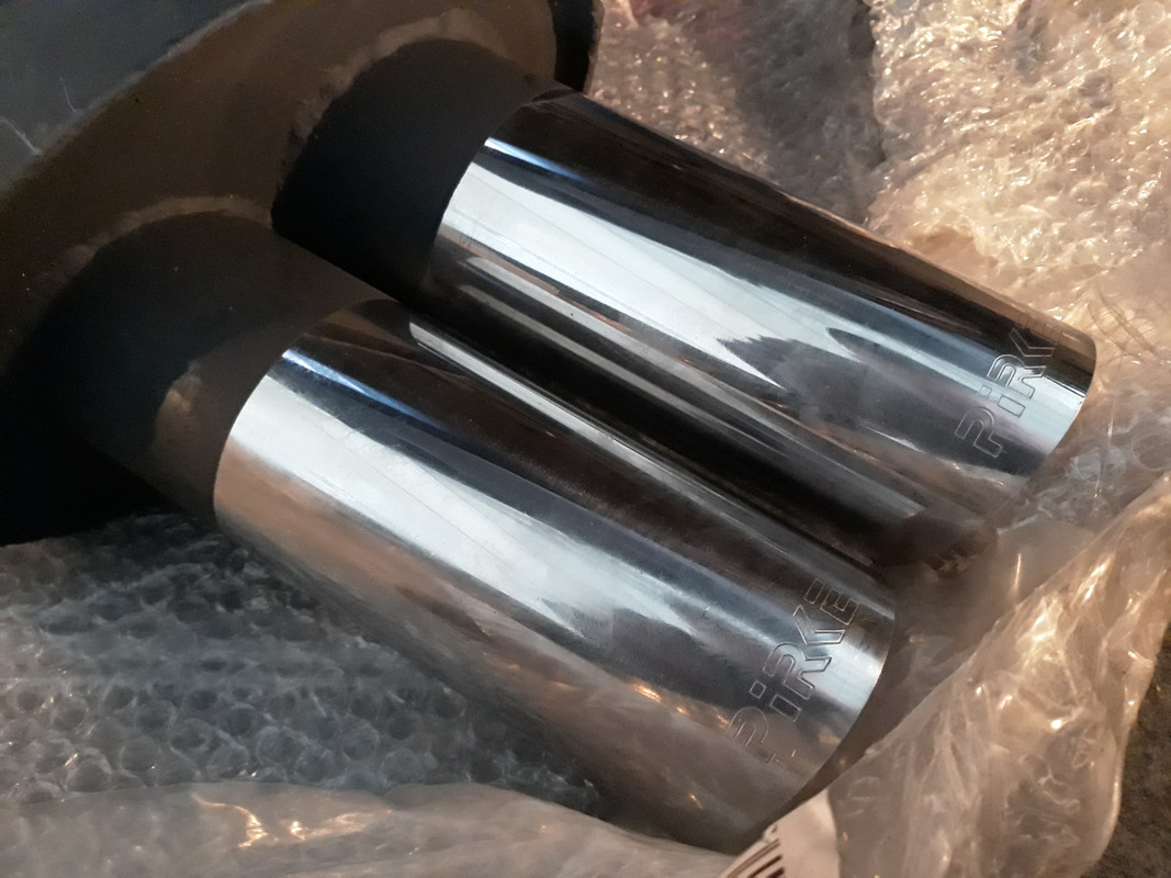

Marence 0 Posted February 5, 2019 Author Report Share Posted February 5, 2019 Stigao mi lonac, montaza prekosutra. Kvalitet izrade vrhunski, svaka preporuka. Link to post Share on other sites
