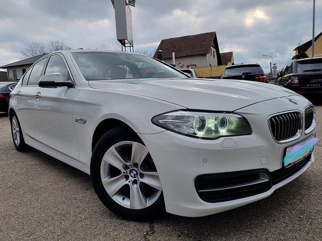

Renault Terminator 0 Posted January 15 Report Share Posted January 15 Evo jedne slike za početak,prije nego što krenem sa nekom detaljnijom pričom,još se upoznajem sa autom. Link to post Share on other sites

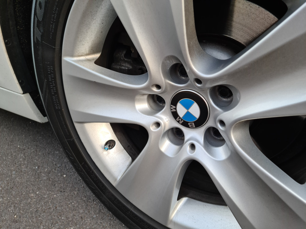

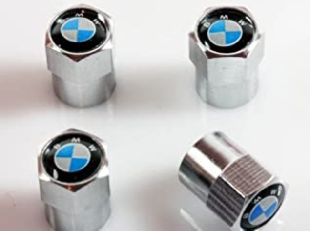

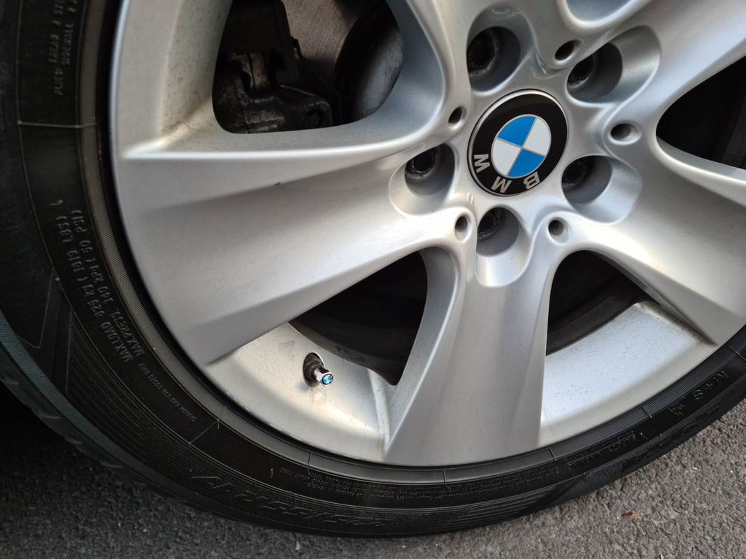

Renault Terminator 0 Posted February 23 Author Report Share Posted February 23 Stigle kapice za ventile.Bio sam lijen prati felne za fotke😁.. Link to post Share on other sites
